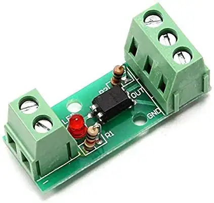

The inductive sensors work better when you apply a higher voltage than 5 V. Usually they are rated for 6-36 V, but please do check.
To prevent frying your board when connecting the sensor to (12 or) 24 Volts you could optically isolate the 5 V and the (12 or) 24 V circuit with an OptoCoupler module:
Image of an optocoupler module
OptoCoupler module

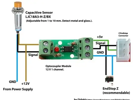

This module uses an optical switch based on the output of the sensor and should be correctly connected:
Image of connecting an optocoupler module to the sensor and to the board
Please note that the image uses a capacitive sensor rather than a inductive sensor, both are connected similarly wiring of an optocoupler module
Note that there are many sorts of sensors, a few are listed here. Generally speaking, the larger the diameter of the sensor, the larger the detection distance to the bed. Note that these work well with metal beds (Iron/steel better than Aluminium), but will not work for glass (capacitive sensors work on glass but are prone to drift by moisture in the air, a touch sensor may then be a better alternative).

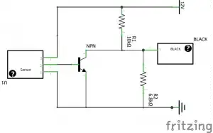

Another possibility is to create a voltage divider circuit.
In electronics, a voltage divider (also known as a potential divider) is a passive linear circuit that produces an output voltage (Vout) that is a fraction of its input voltage (Vin). Voltage division is the result of distributing the input voltage among the components of the divider. A simple example of a voltage divider is two resistors connected in series, with the input voltage applied across the resistor pair and the output voltage emerging from the connection between them.
Note that fluctuating voltages of the power supply can have side effects that the voltage of the divider is either too low or high for the pin and could result in either a detection miss or could burn the on board processor.
A voltage divider based on 12 V is depicted below based on this source:
12 V voltage divider
Please note that for different voltage you require a different value, e.g. for 24 V you would require (by calculation) a 2.63 kΩ resistor (which does not exist, so put two resistors in series; a 2.2 kΩ and a 430 Ω to get that value).
