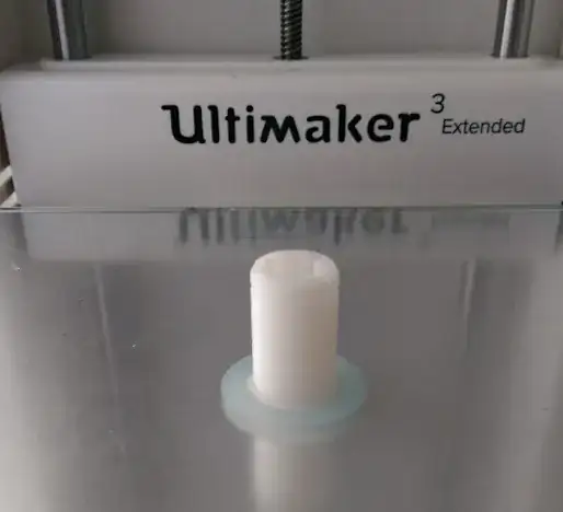

My experience with printing this material is based on printing with an Ultimaker 3 Extended (on glass) using a modified material profile (based on Nylon). It is printed at 240 °C (+5 °C for the first layer), no usage of the part cooling fan (if you do use cooling, the layers will not adhere well), a heated bed temperature of 80 °C, and a slow printing speed of 40 mm/s (20 mm/s for the first and second layer).
Ultimaker 3 Extended with printed POM bearing:
First thing I learned is to use quite large brim's (the image above shows a rather small one for this short bearing, for the longer bearings the brim size was more than doubled, e.g. 20 mm), brims enlarge the surface area so that there is more material that grabs hold of the heated bed. Also ensure to get it to stick long enough is heating the bed to 80 °C after smearing ABS juice (ABS dissolved in acetone) and spraying a PVA based spray over the dried ABS juice layer (3DLAC has been used, but other hairsprays or even gluesticks may work as well, as long as there is PVA in it). The temperature of 80 °C is chosen as this is the temperature where my PVA spray has the most tack/sticky-ness.

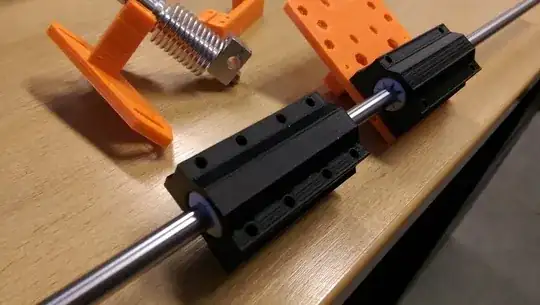

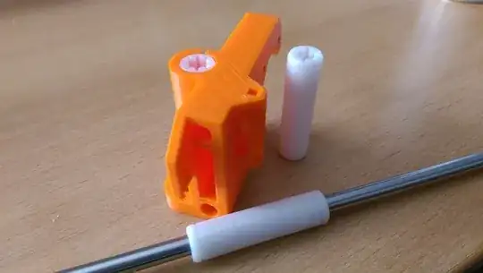

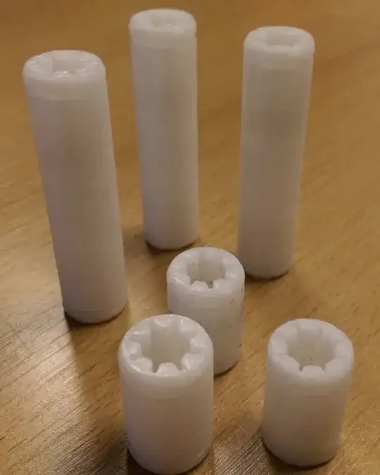

Collection of POM printed bearings:

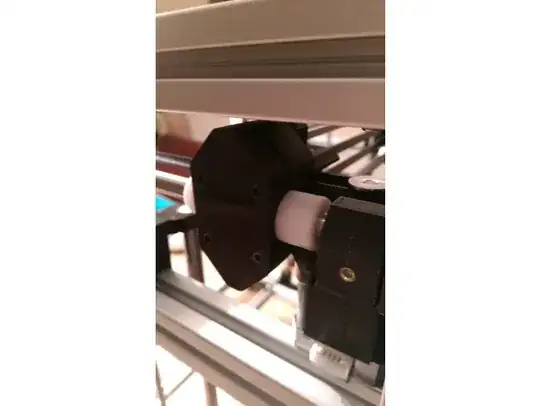

Another application of POM bearings:
Bowden E3D mount

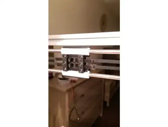

CoreXY hot end carriage
Hypercube Evolution hot end carriageHypercube Evolution X-Y mount bearing
