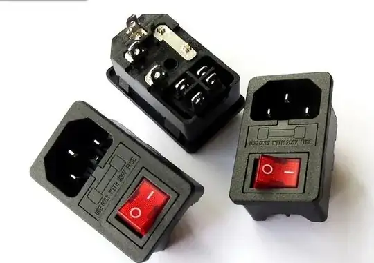

You can insert a power button in the power cord yourself for ease of use.
Furthermore, it is pretty common to replace the power cord for a computer power cord with a C13 plug and connect a C14 socket with power button (and an optional fuse) to the power supply unit:
C14 socket
Please note that it is very dangerous to mess with the mains voltage, so please be sure what you do or get help from someone that does. Use proper tools to crimp wire correctors to the leads.

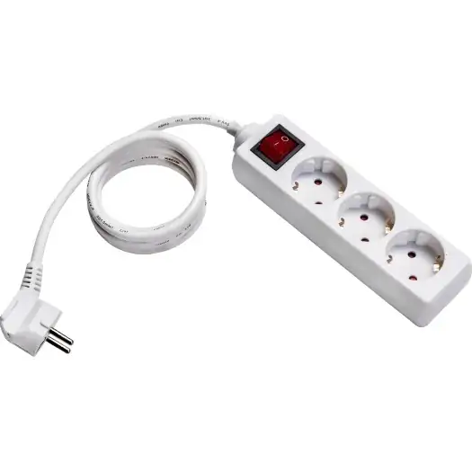

If you are not able to do the rewiring of cables to put in a switch, plug the printer into a power strip with an integrated switch button.
