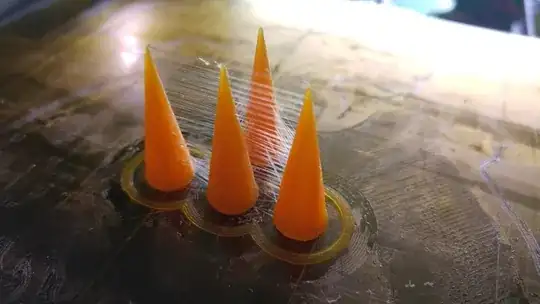

Retraction is the reversal of the direction of the filament and is generally used when moving from one non-contiguous point of the print to another, in order to prevent stringing and oozing of the filament. If retraction is not employed then the filament still coming out of the nozzle, after the last point was printed (and paused), will stretch, thus creating a fine string, as the print head is moved to the next position where printing is to recommence.
Stringing
The retraction speed is the speed at which the filament is retracted, or pulled back (by the extruder stepper), and the retraction length is the amount that is pulled back.

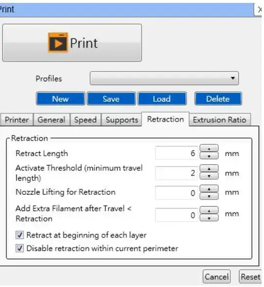

These settings are dealt with in the XYZware User manual, on page 43, section 11.5 Retraction
11.5 Retraction
Retraction dialog
11.5.1 Retract Length
In printing object, before large movement of print module, print filament will be drawn back, such that slight negative pressure occurs in print nozzle, preventing material from adhering to the object while moving, improving surface quality of print object
11.5.2 Activate Threshold
Such setting will allow users to set up retraction mechanism activation style. For setup mode, users usually specify the minimal print module movement distance for retraction mechanism activation
11.5.3 Lifting height for extruder withdrawal
After retraction, the print module will be elevated slightly with such setup value. Such action prevents material from adhering to the object, and makes a more orderly final print stop point. However, it should be noted that excessively large elevation will extend print preparation time for the next print layer, and portions of angles may results cooling and difficult to bond conditions between layers
11.5.4 Add Extra Filament after Travel < Retraction
Material compensation may be used to improve upon holes or poor extrusion due to excessive extruder withdrawal

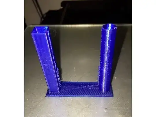

Calibration Object: oozebane-test.stl
The calibration object prints two towers about 30 mm apart. The head must move between each of the towers at each layer. If your printer is not set correctly then you will see many fine filaments (or strings) between the two towers. You can eliminate these filaments by eliminating ooze.
Calibration Object 2 (Variable sized towers for testing ooze): variable_size_ooze_test_nobase.stl
This is a simple model to help tune reversal parameters for a stepper extruder (using much less filament before actually testing the ooziness). It consists of a number of towers with different thicknesses, with different spacing between each tower. A well-tuned bot should be able to produce even the smallest towers.
A simple google search, thingiverse retraction, shows up a lot of examples, such as:
Retraction tower
Check out the following (suspiciously similar) tags1, for even more examples:
