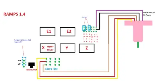

Has anyone configured BLTouch with Marlin firmware?
I could only find videos about older firmware version. I followed this document. To avoid causing any damage to the printer, I removed all connections, took the board out and connected a stepper to Z-axis terminal and BLTouch to Z-min and servo 1. All other axes are not connected. X-min and Y-min end stops were shorted using jumper (Mine is NC configuration).
After updating the firmware, I can move the X and Y steppers, but not Z stepper. There's a blue light glowing inside BLTouch, which turns off if I remove Servo connections.
The M119 command shows all end stops are open.
Do I have to change pull up settings of end stop?

Edit: The answer below reflected the original question and upload of the configuration that was incorrectly configured. The value of this answer can be found in checking your configuration thoroughly before you post a question. It also answers the question whether pull-up resistors need to be set for the end stops.
Basically you need to follow the instructions of the manual/sheet you mention in your question. Be sure to get all the changes correct in your configuration.h file!
E.g. in your configuration
//#define NUM_SERVOS 3 // Servo index starts with 0 for M280 command
should be
So no servo was defined (the servo pulls up the pin of the BLTouch sensor)! Also your BLTouch delay is 375 while 100 is prescribed. Please check that you managed to get all the proposed changes in the configuration file (as I stopped comparing for you after finding 2 errors in your configuration!) as I believe that you have not updated your configuration correctly as described. There should be no differences in setup for Marlin 1.1.6 or 1.1.8.
To answer your question: No, you do not need to change pull-up settings.
