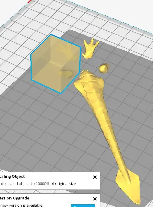

I've made a 9H-printing model tonight, and only a little part of it failed (because a support dropped off). I want to reprint only that little part.
How can I do that in Cura? How can I tell Cura to generate a gcode file so only that little part (inside the transparent cube below) will be printed?
The part I want to print is the one inside the transparent cube
I've placed the model upside-down on the Cura plate to "cut off" what was well printed. I've made a simple 3D cube model in Blender and placed it so it intersect with the part I want to print (I've set the "mesh type" of that cube to "don't support overlaps" for that). I've tried using "Mesh fixes: disable Union Overlapping Volumes" and the "Merge meshes" option, but the merge aligns the cube origin and the model origin (which I don't want).
What's the proper way to do such partial printing?

The latest version of Ultimaker Cura can do that (version 3.6).
I have built models made of different material in the same model.
How to do this is:
  1. Select your CUBE and select the icon "Per Model Setting" in left side menu.
  2. choice "Normal model", select the following settings: Top/bottom thickness, wall thickness and infill percentage
  3. Very Important: all above settings must be set to 0!
  4. Select the model you desire to print and select the icon "Per Model Setting" in left side menu
  5. choice "Modify settings for overlap with other model" and select the following settings: Top/bottom thickness, wall thickness and infill percentage
  6. Select the desired infill percentage and the wall top/bottom thickness for the portion you want print
  7. slice the model
Note: If you need to print supports, then in step 2 select "Modify settings for infill of other models" (instead of "Normal Model"), and in step 6 also select "Add Support" and any other support related parameters you may need. However, Cura needs at least one "Normal Model" to slice, so to fool it you need to also another Cube as "Normal Model" with the parameters of step 4 somewhere else in your build plate (it won't really print).
