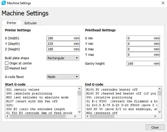

I am using CURA as my slicer, and it sets the bed and nozzle temp before printer start code is executed. You can easily check that by opening a file in a notepad and see, that there will be a few lines describing the job, nozzle and bed setting temperature and the user code that is inserted in printer properties screen.
To change that behavior - you need to open the file and move the M commands down after leveling is executed.
;FLAVOR:Marlin
;TIME:45
;Filament used: 0.0187665m
;Layer height: 0.2
;Generated with Cura_SteamEngine 3.3.1
M190 S60
M104 S200
M109 S200M82 ;absolute extrusion mode
lines above are added by slicer so temperature is set before instritions from START G-Code section:
G21 ;metric values
G90 ;absolute positioning
M82 ;set extruder to absolute mode
M107 ;start with the fan off
G28;
G92 E0 ;zero the extruded length
G1 F20 E3 ;extrude 3mm of feed stock
G92 E0 ;zero the extruded length again
user start g-code screen
