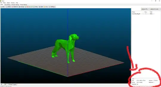

Using Slic3r you will have object details in the corner enter image description here

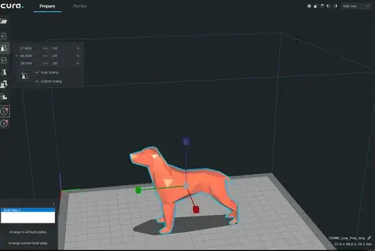

Using CURA you will have a detailed view in scale mode enter image description here

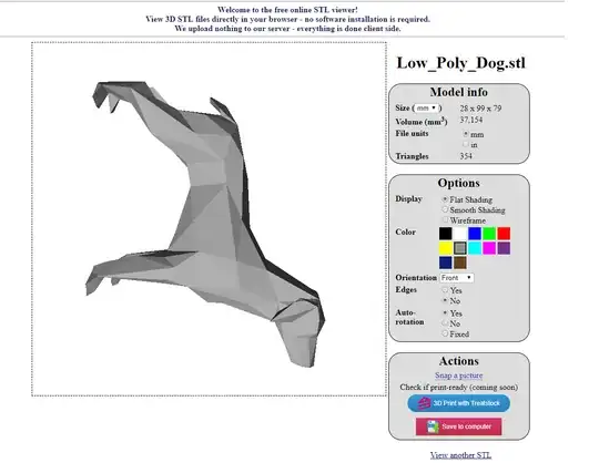

Also you can use online services CLICK an online service stl viewer
