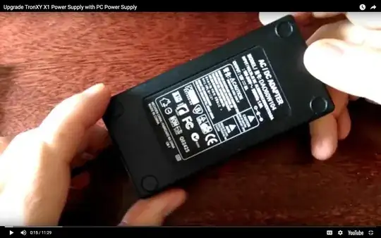

According to this video, Upgrade TronXY X1 Power Supply with PC Power Supply, which actually shows the power brick, the TronXY power brick is 12 V 5 A. The best screenshot of the brick is shown below:
TronXY power brick power rating
The narrator of the video (as do other sources) states that it runs extremely hot on long print cycles.
