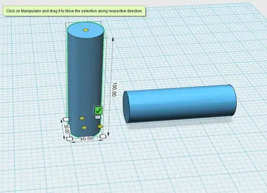

I have got a Lulzbot TAZ6 3 days ago. Last night I started a print which is 21 hours long and when I returned check on it this afternoon it was a complete mess. These are the objects that I wanted to print: enter image description here

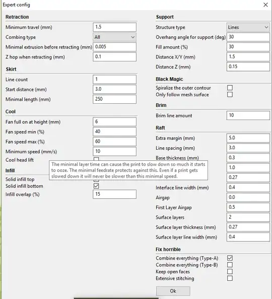

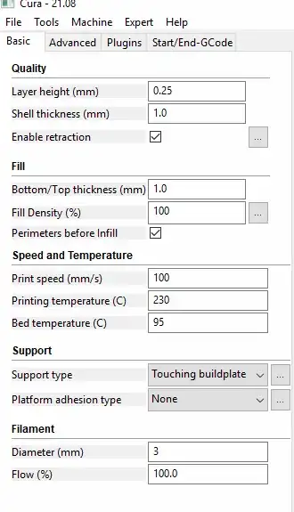

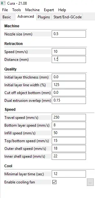

I used Cura LUlzbot edition for printing this, the settings I have opted are: enter image description here enter image description here enter image description here

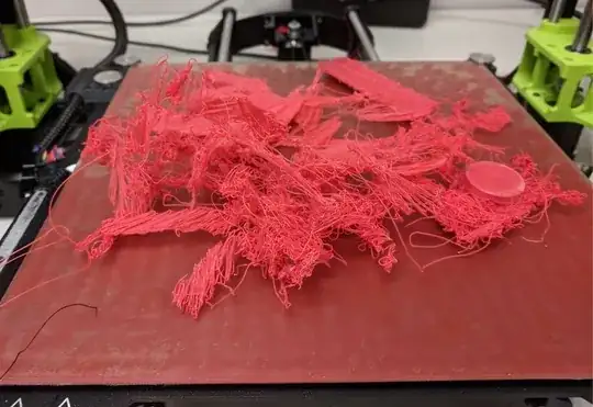

I need to print them with 100% infill for my project. I printed it over USB, and the cura was still running when I checked now, so i guess its not because of the computer shutdown. This used to happen when I tried printing these on Lulzbot KITTAZ i have, but its not working so I got TAZ6. Please let me know where i'm going wrong. enter image description here This was the state of the print(some of it was sticking to the printbed, this picture was taken after i removed it from the printbed)

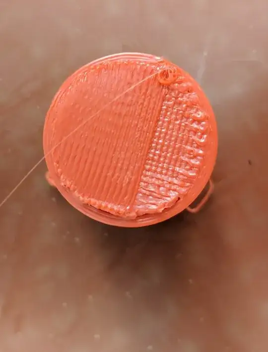

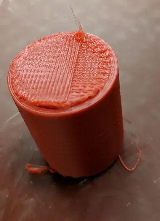

Thanks for the suggestion. I have calibrated the extruder and tried to print only the vertical cylinder. I have changed only one setting, changed the extrusion multiplier to .99. I kept the infill density to 100%(my project needs a cylinder to be completely filled without any air gaps) to see which of those two has greater influence on the print quality. All the other settings were the same here is the result(After I saw this I cancelled the print): enter image description here enter image description here
Like you suggested the infill is overflowing. What should I do next, i'm concerned if it is printed with reduced infill percentage its density will decrease. Shall I try to print it with 97% and see what happens?

Unluckily - for as much information on your settings you share - it is very difficult to diagnose the problem without knowing how the print failed. Did a piece become dislodged? Did the nozzle caught onto a printed piece? Did the head began extrude in mid air? ...?
However this are my guesses:
  • From your temp settings it looks like you are printing ABS. If this is the case, have you placed your printer in an enclosure? With ABS, It is very very difficult (if not impossible) to print anything above "small", without an enclosure.
  • Printing 100% infill is normally a bad idea. If you are doing it for strength, then you should know that the strength gains are progressively smaller on anything above 60%. 100% infill also means that unless your extrusion is perfectly calibrated (which I suspect it may not be the case, given that your setting is the default 100%) any amount of overextrusion will likely let the nozzle "catch". Finally, 100% extrusion also increases the warping forces on the piece considerably.
