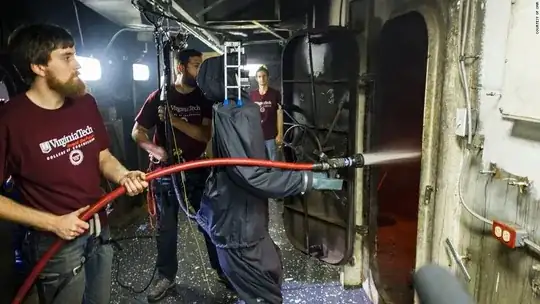

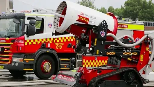

Firefighting Robot
You could build a robot to detect fires about put them out, as sort of an advanced automatic suppression system. Something like Tony Stark's robot, or something emulating what is actually in service (US Navy (CNN), Australia tracked firefighter).
