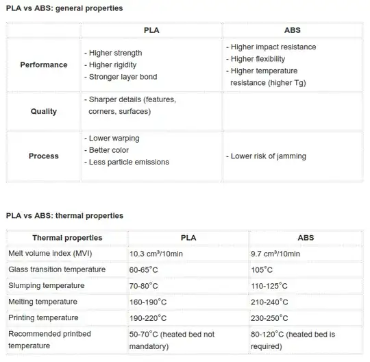

PLA/ABS general and thermal properties
PLA vs ABS general properties PLA ABS Performance Higher strength Higher rigidity Stronger layer bond Higher impact resistance Higher flexibility Higher temperature resistance higher Tg Quality Sharper details features corners surfaces Process Lower warping Better color Les particle emissions Lower risk of jamming
