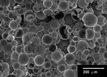

If you determine that such material is not a good solution or would rather not take the gamble or perform the tests, you have an option with another product called microballoons or microspheres. It is a product that has an accurate description. The material is hollow spheres of glass of such tiny dimensions that they will blow away if you breathe on them.
The primary purpose of this product is to fill gaps, create fillets and similar structures without adding appreciable weight. One would use them with thin epoxy resin and mix to desired consistency. Some descriptions include "mayonnaise or peanut butter" depending on the application.
With both of these products, easily sanded is also in the description, although your choice of epoxy will also contribute to that aspect. Because the microballoons are mostly air, they do sand quite cleanly when mixed to heavy or thick consistency.
microballoons
