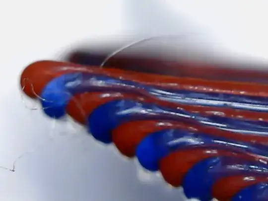

0.1 mm layer height is important to keep overhangs small, see video

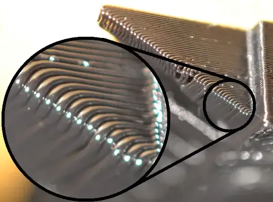

I have found that I get slightly different results with different printers and different plastics and print temperatures. For doing parts like nuts and bolts you will probably have to print several prototype parts once you get your printer to get the setting and tolerances right, once you get a print. But just decreasing the layer height and getting the nozzle temp and cooling right should let you get some working parts. Slope failure You can get the sloped surfaces the still look ok but are not dimensional accurate with to high an angle. I find if is easiest to print and then test and then adjust the tolerances on the design. enter image description here
