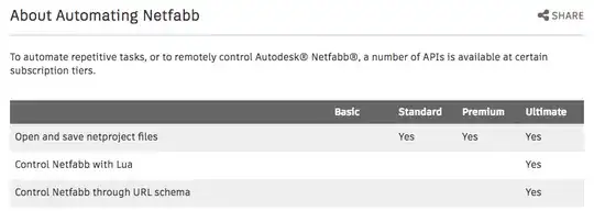

However, it is unclear as to whether there is a cmd line interface. It could be worth reading Problem in Netfabb Command Line execution and in particular the documentation on Automating Netfabb - although this seems to suggest that command line functionality is only available to users with Ultimate subscription and not Basic:
Automating Netfabb
From Reducing Size of STL file to upload to shapeways, this post (#10) states:
You can also decimate the model in Netfabb easily - Right click > Level of Detail > Choose something like 50%... or more or less depending on the level of detail needed.
Although, this isn't available in Basic subscription, or so says post #12.

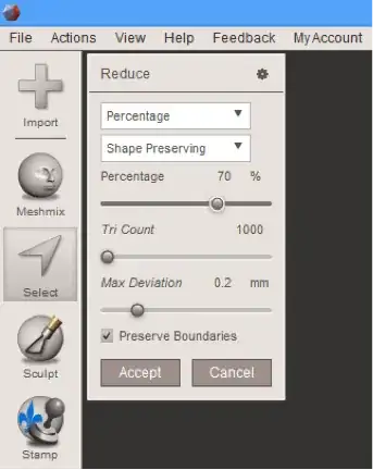

From How to Reduce the File Size of .STL and .OBJ 3D Models
For example, you can give the free 3D modeling program Meshmixer a try. Choose the ‘Select’ tool from the menu on the right, then double-click on your model (this will select your entire mesh). Then click on the ‘Edit…’ option and select ‘Reduce’.
You can now reduce the polygon count using several options. The best working choice is to use the percentage tool. It will immediately tell you by how much percent your file size (and polygon count) has been reduced.
Available for Windows and OSX.

The last problem that you may stumble upon, particularly as your objects get larger and their complexity increases, is that the resulting .stl file size is too large for your 3D printer or 3D printing service of choice. Third party printing services like i.materialise or Shapeways have upload limits so you may have to change the size of your file (100 MB limit at imaterialise and 64 MB for Shapeways). It’s important to reduce the mesh without sacrificing the quality, which I should say at the outset is best done at the initial export from your CAD software to minimise any distortion. My number one quick tip is to make sure in the export settings that your saving in ‘Binary’ format, not ‘ASCII’ – it’s a significantly more compact file format for .stl’s without losing quality). However if it’s not an option, Meshmixer can be really useful to quickly reduce file size and visualise how this will affect the quality of your surfaces.
For this example I’m going to return to the leaf from Problem 1, which as a .stl file is 30.757 MB – pretty large for such a small design and definitely over the limit for someone’s email if I wanted to send it. So let’s look at how we can get this under 10 MB.
  1. Select the entire model by pressing Ctrl + A on your keyboard to select all.
  2. Go to Edit>Reduce to bring up the options to reduce the mesh. Essentially the file size of a .stl is directly related to the number of polygons (triangles) that make up all of the surfaces. We will use the Reduce tool to reduce the quantity of polygons, therefore reducing file size.
  3. The menu will give you a range of options to reduce the size of your file. The simplest is to use the default Percentage option, allowing you to determine the final file size you want rather than needing to know exactly how many triangles will be used to make up the file. In this case I have calculated that in order to get my original .stl file below 10 MB, I need a reduction of 70 % or more. As you adjust the values, you will get a preview of what your model will look like, allowing you to control how much reduction you employ before the model becomes too distorted and ‘pixelated.’
Reduce dialog
  1. Once you’re happy and have accepted the changes, you can click on the Export button or go to File>Export to save this new reduced .stl file. As you can see in the comparison below, there is almost no perceptible difference in the quality of the 30.757 MB file compared with the final reduced version at 9.362 MB. I have simply increased the size of the triangles, minimising the quantity needed to create the same volume. Your regular 3D printer, or even a highly accurate SLS printer will never even know the difference in a change like this. It’s only if you really go crazy with the file reduction that you might start to notice them in your final print (and in fact many of the low-poly models which are popular on Pinshape can be produced using this technique – start with a detailed .stl of the object you want, and then just keep reducing the number of triangles!).
