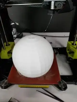

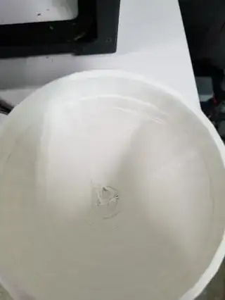

Following up on this, the answer is, yes, this works quite well. I printed this cabaça model from Thingiverse using PLA on a Lulzbot Mini and put it on my berimbau today to test it out. I can't make a direct comparison because the printed resonator is smaller than the gourd one that I own, but the sound is good. I am not certain whether it is actually cheaper (it used a fair amount of PLA because it's probably about a half-inch thick, and it took a few tries to get a good print due to it taking about 9 hours and needing to be monitored for the filament breaking), but it may be more accessible for people who can't ship a gourd in from Brazil. It is definitely more durable.
Exterior view of *cabaça* on the printer (click to enlarge)
Interior view of *cabaça* - Note some stringing on the inside (click to enlarge)

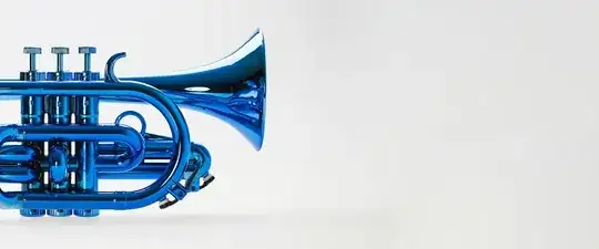

So, we all know it, you can make plastic musical toys. They never resonate as well as metal, glass, or wood; but, they often can work. Here is an example of a Trumpet made out of ABS! enter image description here

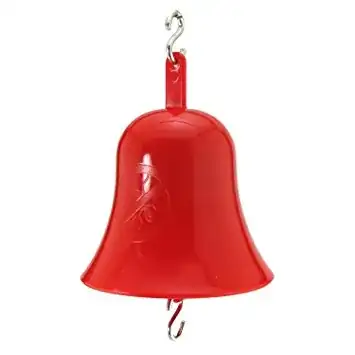

All that said, all the plastic bells I have seen are generally pretty quiet. Plastic has a habit of absorbing energy and thus not being a very good resonator. If you want to try, I think you are going to have to find a way to harden the plastic. Maybe Acetone treated PLA as that seems to harden it. Maybe try something simple like printing a plastic bell. If you can get that to ring, you are well on your well.
