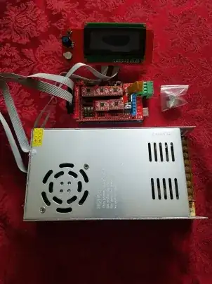

Another option (the one I chose) is to just buy a RAMPS board set. I got one on ebay for $19 and it have lots of more options for IO. That way you can play and still go back and plug in your stock Melzi and print whenever you need it.
I got all this for $40 - boards, display, cables, power supply, and even shipping enter image description here
