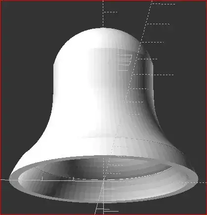

The direction that fred pointed me at is viable. I didn't use the actual image shown here, but a manually generated one from OpenScad. As a proof of concept the technique works well.

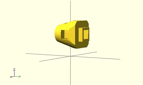

As you are already familiar with OpenSCAD, consider to use the projection() function to accomplish your goal.
If you allow for an interpretation that one can cast a shadow of the part on a surface below, it becomes a 2D representation of the part. This is effectively how projection works in OpenSCAD.

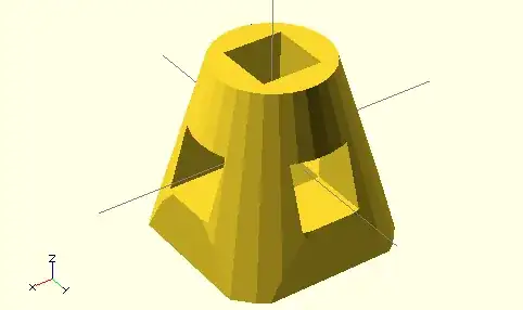

Note that the part image below is centered in x, y, z and the cut/projection action takes place at the z = 0 plane:
sample model image

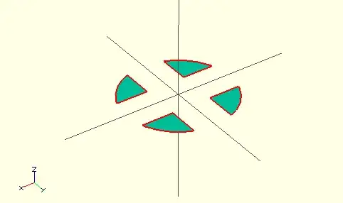

When the function is applied to this model, the result is a non-contiguous 2d image:
projected cut image

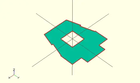

When the cut parameter is ignored or set to false, the image which results is effectively an orthogonal shadow of the entire object, rather than a selected slice:
flat shadow image

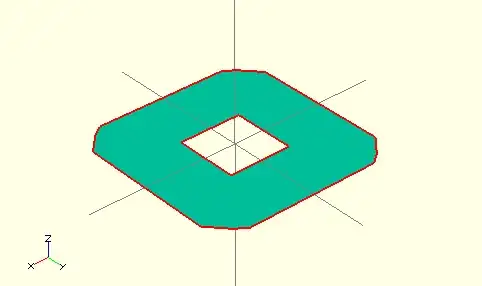

It gets better, of course. In OpenSCAD, the translate, rotate and scale functions apply. One can tip a model over, resize it, spin it around, combine with the cut parameter and get any combination of 2d image from the original model:
rotated model image
shadow rotated model

Re-reading your post, I also missed part of a more useful answer. Once you have the profile you desire, you can use the rotate_extrude function on the profile you generate. Despite the non-zero thickness, it uses the zero-thickness aspect to create the model from that function.
