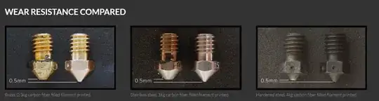

The creators of the Olsson Ruby Nozzle have published some pictures of wear on brass, steel and hardened steel nozzles. From their website the following image is taken:
Nozzle wear
Depending on the amount of filament that is being printed, not only the internal dimensions, but also the outer dimension change considerably. This is clearly visible in the images. Comparing your nozzle to a similar new nozzle might give you an idea of the wear of your nozzle. It is expected that long before the nozzle reaches this state, you need to readjust the bed to nozzle distance and the flow modifier, you will see this in the quality of your prints and the first layer sticking to the bed. So, the more (frequent) you need to tinker to get the print to stick or to print successfully and dimensionally correct, the bigger the change your nozzle has worn.
