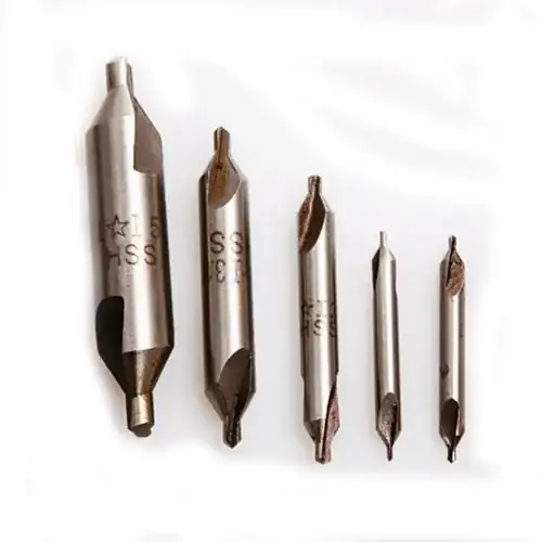

Center drills are available with 60 degree angles as well: Amazon specific item enter image description here
The second smallest center drill listed here has a 1.5 mm center point with a 4 mm drill point. If your coupling is larger than 4 mm, the next size up will not work as well, as the center point is 2.5 mm. You'd have to resort to a countersink only.

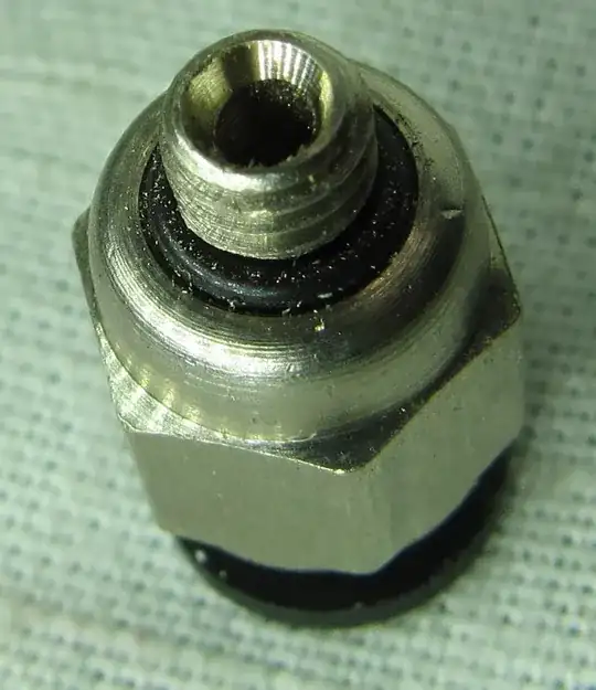

I have a mini-mill and a collection of countersinks as well as center drills. I found my bag of unused couplers. They are for 5 mm tubing and were flat on the threaded end. This is the result after a quick trip to the mill. It appears in the close up that I could have driven the center drill deeper into the fitting, and also cleaned off the swarf a bit as well.
Chamfered inner hole backside of the pneumatic coupler

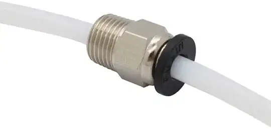

An alternative to chamfering the connector is buying a different type of connectors with a larger bore hole all the way through the connector and let the tube pass all the way through. These are used in my similar spool to extruder setup (reversed Bowden setup in OP's terminology).
Large hole pneumatic tube connector
