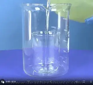

Submerging the glass in mineral oil should make it disappear if it is borosilicate glass, as demonstrated below. This phenomenon is known as the "index matching" effect. The index of refraction of borosilicate glass is n=1.47, and that of mineral oil is also around n=1.47, depending on the type of mineral oil used. However, as mentioned in this comment, other types of glass might have a similar or close refraction index, making it hard to distinguish borosilicate from non-borosilicate using this test alone.
The borosilicate glass and the oil have roughly the same index of refraction. When this beaker is immersed into a container of oil, the beaker becomes invisible.
An animated GIF of a small beaker inside of a larger beaker and cooking oil being poured into the smaller beaker overflowing into the larger
Source: The Disappearing Beaker Experiment
