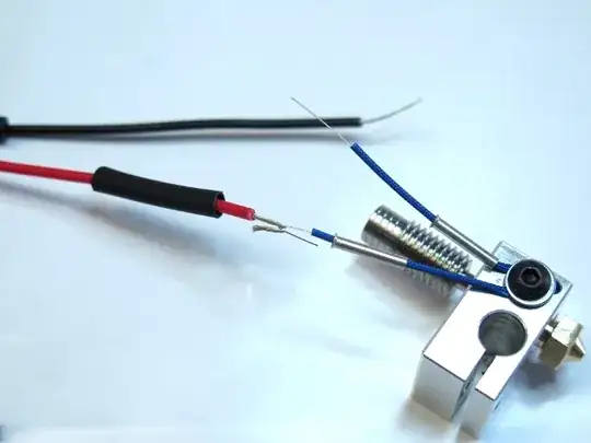

E3D hotends use a thermistor whose legs are insulated with glass fiber sleeving and clamped down with a screw and washer:
This solution enables the printing of high temperature materials, but it's a bit fragile and after reassembling the hotend a couple of times, the screw will have thoroughly mangled the thermistor's legs and sleeving.

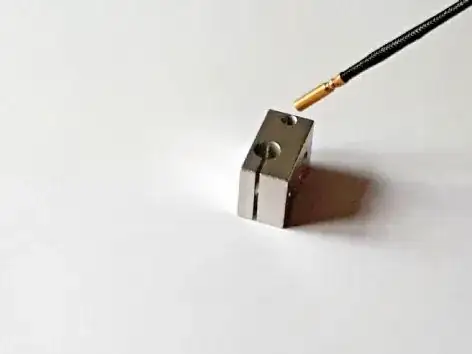

I have now purchased a hot-end block from here, that has a "cartridge style" cylindrical thermistor that fits into a drilled hole of the hot-end block, and is fixed by an additional screw. This system makes maintenance much easier, the thermistor slides in and out without force, and it has a connector to change only thermistor (or unscrew hot-end block without removing cables if your hot-end also has a connector).
cyclindrical cartridge thermistor
I highly recommend this upgrade, if you are using older-style hot-ends, because it makes maintenance much easier.
