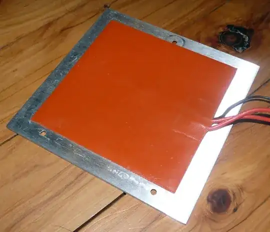

I am heating my 1 meter by 1 meter plate (yes those numbers are correct) (in progress long term project) of tempered glass with a silicone heater bed I bought as overstock on ebay. Silicone Heating Mat
Silicon bed
From Reprap Wiki
Silicone Heater Pad in sizes silicone heater pad Pros: Fast heating Reliable Most use mains voltage - DOESN'T require any amps from the 12 volt supply Very low height Easy to install (adhesive backed) Can be relatively inexpensive 12 V types can be run directly from the controller MOSFET without a relay Integrated thermistor Long life span Cons: Can be expensive - silicon mat (50€) plus solid state relay (16€). Mains voltage, but can be purchased for 12 V. Need GROUND line to aluminum bed for safety. Relatively high temperatures possible (safety problem if thermistor dies/falls off).
I also talked to a few alibaba companies and they will happily make you a custom order. Just be wary working with them. You will also need to start another question about the particular parts you need. Actually I think I have a second one I bought from Aliexpress about that size. So no custom orders needed. Ran about 100 USD. I will note I used a MIC6 aluminum plate, custom cut at a local shop. That will have a more even heat profile than glass.
I will note that I have to run mine from 220 VAC not 110 VAC power lines.. But the actual electrical costs are pretty low!
