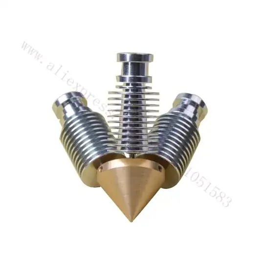

This came up in one of my groups today. That we could not color bend, or mix 3d printing filaments. I have researched but I am not finding anything talking about Plastic mixing in an extruder.
Why is it that we cannot take say a Diamond hotend, or a hotend with 5+ inputs, and mix any color we want? (assuming all the same type, ABSm, PLA). I think it would be interesting to at the least get a gradient effect on prints.

I just started with google and phrase "3d printing color mixing" and on the first place (in fact first two were valueless adverts) I got this Instructables - DIY Full Color Mixing 3D Printer.
How it works?
It uses magenta / cyan / yellow filaments and mixes it while printing with Diamond hotend.
It definitely does what you are asking for and it's exactly the same idea you come up with ;)

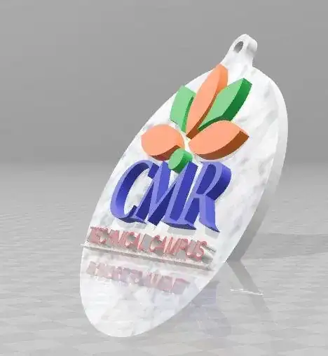

If you clearly observe the geometry of the print it has printed in different colours .the part is designed in such a way that it has the small height gap between the each colour but we cannot seen this gap in one projection plane.. We can print only in direct drive extrusion .by changing the filament of different colours without pausing the print by immediately changing the material . It is printed in single nozzle. The above image clears your doubt.it is designed with different heights.enter image description here
