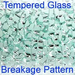

Another option, my favorite is Tempered glass. I have never had it flake apart as I try to remove from the bed. Also it is stronger, doesn't shatter into razers.
Tempered Glass break pattern
