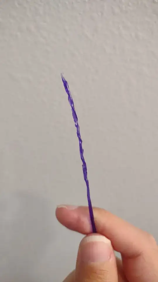

I have an Ender 3 Pro fitted with a CRTouch (I previously said it was a BLTouch but I was mistaken), and it was working fine until a while ago when suddenly it stopped extruding but only when actually printing.
I'm printing with PLA, but the issue happens with two different PLA filaments by different manufacturers, so I don't think the exact type matters.
The filament seems to be coming out of the nozzle perfectly fine in every situation except printing. I check this by raising the Z height high enough for me to see the nozzle, and then I use the menus to move the extruder 10 mm which results in a perfect desirable flow out of the nozzle. But then as soon as I'm printing, the extrusion either stops entirely or severely underextrudes. The gears that pushed the filament through just fine one second ago when I wasn't printing, suddenly start to slip and chew up the filament instead, when I am printing.
I have noticed when pulling the filament out of the printer completely after a failed print that the end has a twisted appearance (not blobs, but an appearance like the filament was being twisted in the hotend somehow. Spirals similar to a drill bit.)
a transparent blue PLA filament is twisted in it's appearance

I have solved the issue on my end. It is related to Z-offset. For some reason ever since I've upgraded to Professional Firmware this issue keeps happening. Basically, I have gone through 4 different Z-offset values in 3 weeks. I do not understand how the printer is changing somehow. The value is saved but needs updating all the time. I have gone from a setting of -2.30 to -2.38 to -2.40 to now -2.55. I was afraid I would be scratching the bed at this point but it's fine.
If you watch your printer doing the purge line when it then moves to the centre it's raising the hotend off the bed to start printing. My printer hasn't been moved and the bed is completely level. This makes no sense to me at all, that's why I'm leaning more toward it being a firmware issue.
Please try this yourself to see if it's the same for you and please let me know if it helps your situation. (P.S I did try to comment but it won't let me, but for some reason, I can post an answer, go figure)
