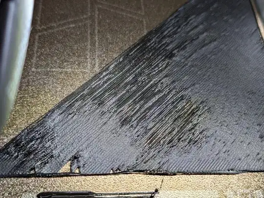

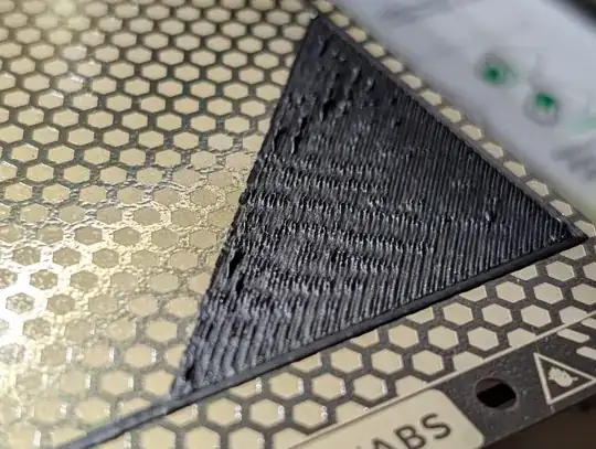

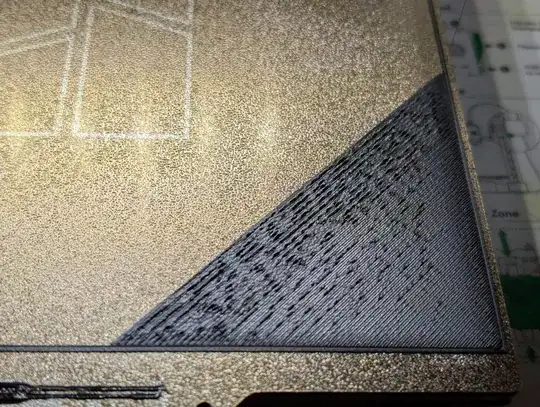

I suddenly just started experiencing wrinkles on the first layer of my prints that can cause the print to get shredded. I'm not sure what's going on. I've tried various things with no success:
  • adjusted print speed
  • adjusted the print bed temperature
  • the nozzle temperature
  • switched build plates
  • cleaned build plates with detergent and water as well as alcohol
  • adjusted layer height
  • switched between setting presets
  • switched filaments
  • cleaned nozzles
  • leveled the print bed
  • factory reset the printer
and nothing seems to work. Using Bambu Labs A1 Mini.
Photo of the first layer of a print job with wrinkles
Photo of the first layer from a different angle
Upclose photo showing the wrinkles on the first layer
I manually leveled the print bed and lowered the print speed even more for the first layer, which seems to have corrected the issue.
