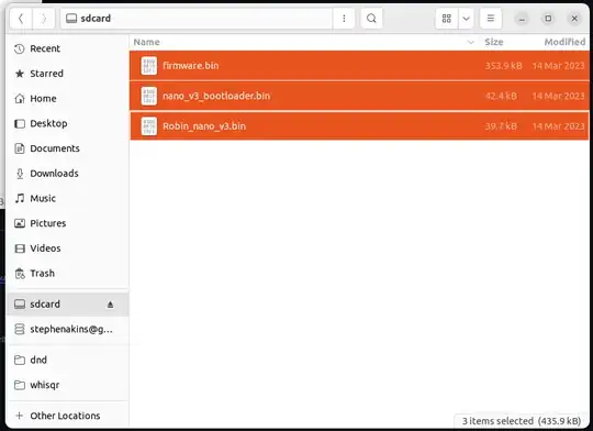

I copied the files from the bootloader/Beep folder onto the SD card and inserted it into the board and powered it on.

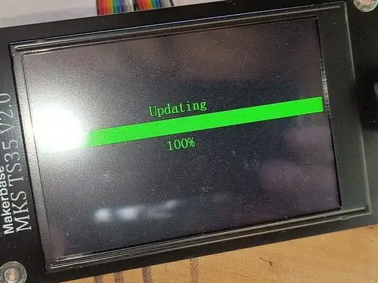

screen capture of files copied to SD card photo of screen during boot
The board powers up and says it's updated. The file nano_v3_bootloader.bin is renamed to NANO_V3_BOOTLOADER.CUR.
But the board is now stuck in a boot loop. The screen flashes (slightly) twice each time it attempts to boot, and on the second flash it beeps.
