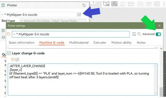

Within OrcaSlicer click the "pencil and pad" to edit your printer preset (indicated by the blue arrow in the image), enable Advanced in the preset window (indicated by the green arrow), then click the Machine G-code tab at the top. Scroll down to the Layer Change G-code pane and enter this code after any code already present:
{if (filament_type[0] == "PLA" and layer_num == 4)}M140 S0; Tool 0 is loaded with PLA, so turning off bed heat after 3 layers.{endif}
...and close the window to save.
Preset settings detail in the Orca slicer.
This G-code tests if the chosen filament is PLA, and if so it turns off the bed when the print job reaches layer 4 (and print continues, it does not wait for the bed to cool). I've tested on PrusaSlicer and OrcaSlicer.
