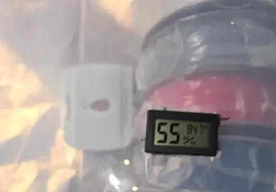

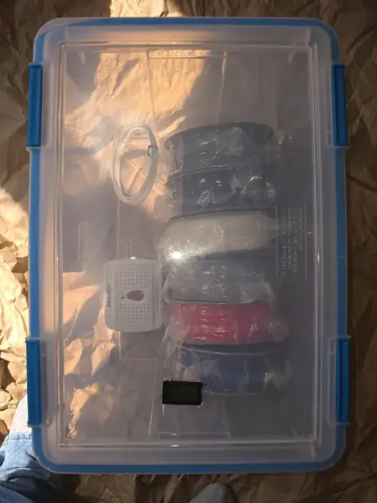

I have several spools of filament, so I built a dry box based on a video from YouTube by Chris Meade.
All the parts were purchased from Amazon (these are not affiliate links). It includes a sealed storage container, a mini hygrometer to measure moisture levels, and a mini dehumidifier. The container size allows for storage of about a dozen full spools, and so far (three weeks or so) has kept the humidity levels in the 25-30% range despite some humid weather. The total cost was around $55 US, half of which was the large storage container; you could reduce this if you could use a smaller container size.
All the parts were purchased on Amazon. (These are not affiliate links. I don't get anything for posting them). Sorry for the poor quality pics - I built it on some paper packaging on the floor of my office, and the lighting isn't great. The photos were taken within about five minutes of building it, so the humidity is still high; it dropped within an hour or so.
Storage box - broad view enter image description here
