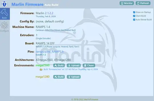

I am building a DIY 3D printer, and my hw requirements are X, Y1, Y2, Z, and E0 steppers. All of them are supposed to be A4988. One hotend heater, no heatbed (by now). My board is an Arduino Mega 2560, and I am trying to use the latest Marlin available (i.e. 2.1.2.2). The issue is that I can't get any movement on the Y2 motor. I have been crawling around, and what I think I should have is as follows:
in Configuration.h,
#define MOTHERBOARD BOARD_RAMPS_14_EFF
#define EXTRUDERS 1
#define Y2_DRIVER_TYPE A4988    //uncommented
in Configuration_adv.h
//#define Y_DUAL_STEPPER_DRIVERS
#if ENABLED(Y_DUAL_STEPPER_DRIVERS)
  #define INVERT_Y2_VS_Y_DIR true   // Set 'true' if Y motors should rotate in opposite directions
  //#define Y_DUAL_ENDSTOPS
  #if ENABLED(Y_DUAL_ENDSTOPS)
    #define Y2_USE_ENDSTOP _YMAX_
    #define Y_DUAL_ENDSTOPS_ADJUSTMENT  0
  #endif
#endif
Note: the #define Y_DUAL_STEPPER_DRIVERS statement has to be left commented otherwise a compilation error is raised. This is the situation. Of course, I have tested the cables/motors, and all of them are working. Other posts on different blogs drove me to tweak the pins_RAMPS.h file, but I realized it was a waste of time. Can you give me a hint? Otherwise, I will be forced to build an add-on nanocard hosting a couple of twin A4988 drivers, but the room on the RAMPS shield is so little. And I don't dare to drive two motors with a single A4988, I never tried but I know that A4988 are difficult guys.

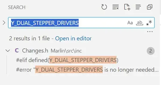

Diving into the code
When looking into the (2.1.2.2) sources you'll see that there is no mention of Y_DUAL_STEPPER_DRIVERS other than in the Changes.h file.
Snippet:
#elif defined(Y_DUAL_STEPPER_DRIVERS)
  #error "Y_DUAL_STEPPER_DRIVERS is no longer needed and should be removed."
This file checks for compatibility of configuration settings against the current "to be compiled" version of Marlin based on your sources. On compilation you get the above mesage when using that Y_DUAL_STEPPER_DRIVERS define statement. The snippet from your question of your Configuration_adv.h is therefore incorrect, you are using a different config file (or you are using an older config file from a previous Marlin version) than should be used for this version of Marlin; hence you have to keep //#define Y_DUAL_STEPPER_DRIVERS in comments!
