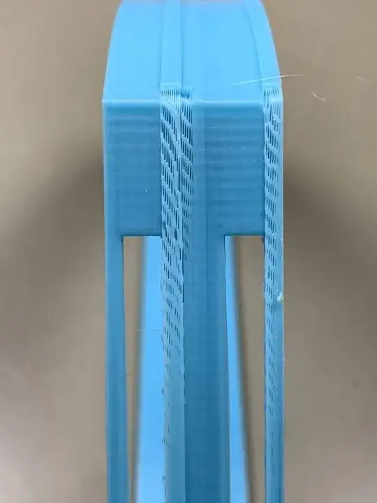

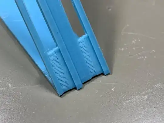

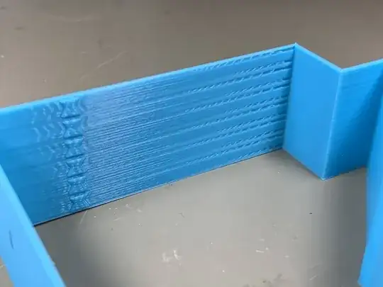

I am getting this under extrusion on my prints but only after travel moves. The rest of the print looks fine.

  • I printed the Teaching Tech 3D Acceleration Tuning Tower and it has the same under extrusion issue in the back left corner inner wall. This would seem to rule out any slicer settings being the cause of this.

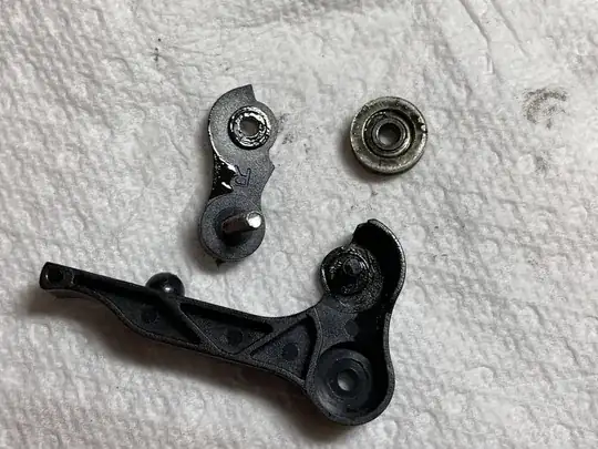

  • I took apart the extruder and found that the v-groove idler wheel that pushes the filament against the extruder gear was full of grease.
It didn't spin freely, it turned but felt mushy. I cleaned the grease from the wheel and the surrounding area and added a drop of sewing machine oil to each side of the wheel. After that, it spun freely.
