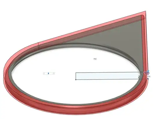

Starting from this sketch:
Sketch showing a curved profile
I've revolved and extruded it to result in the body shown:
3D body resulting from revolving and extruding the sketch

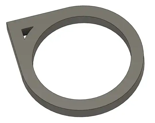

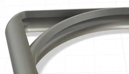

This is destined to be printed, so I need to fill in the cavity of the stick-y-out-y bit. I can use Surface->Patch to make it look correct from the outside, but there's still a void within:
Close-up of cavity
3D body with hole filled in with a surface patch

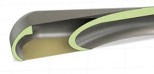

Sectional analysis revealing cavity

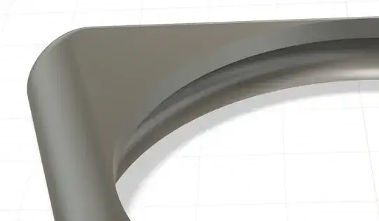

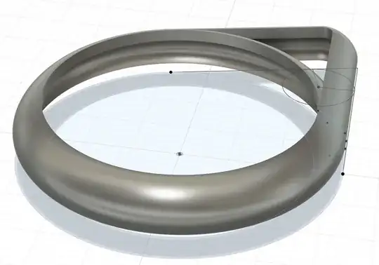

Simplify the order of operations
Sometimes, it is way easier to do the order of operations in a different order:
First, create the thickness of the body. Only then then subtract the rotation profile and last sweep the the outer profile subtractively
enter image description here enter image description here enter image description here

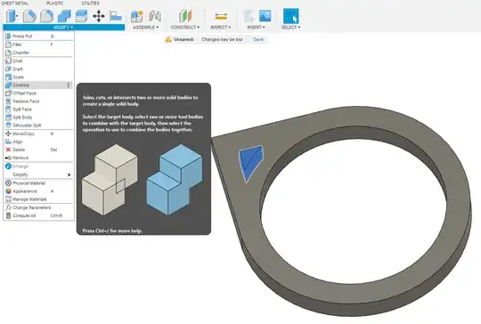

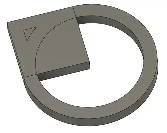

I don't know if there is a tool that can do that (would be very helpful), but you could use boolean operators to do the same!

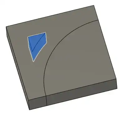

A simplified version of your product looks like:
When you create an box , or part of a box of the same height in the part you need to fill the void it will kook like (2 separate bodies in one view):

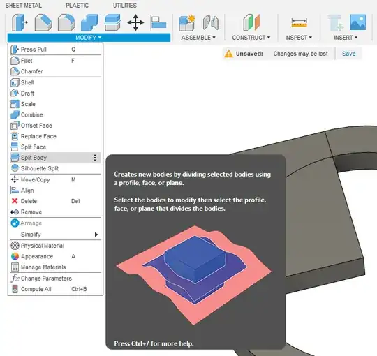

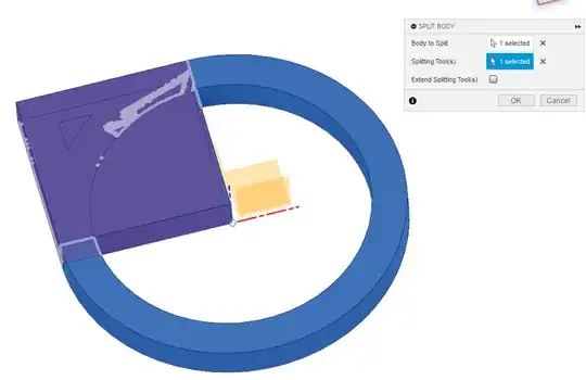

Now use a boolean operator "Split Boby":

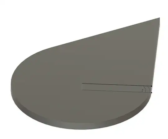

You can subtract your shape from the box:
to get multiple parts (3 parts in this case):
Now use a boolean operator to glue the parts together (option combine):
This will give you your filled void:
