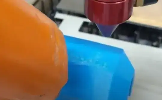

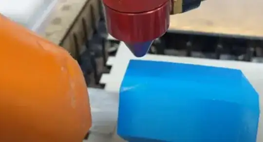

During first engraving with 12 %, notice the thin white smoke at the center where the laser impacts, getting pulled away by the air assist. The engraving itself is visible as a slightly different color. Laser during engraving, visible smoke trail later during engraving, better visibility of the engraving due to angle

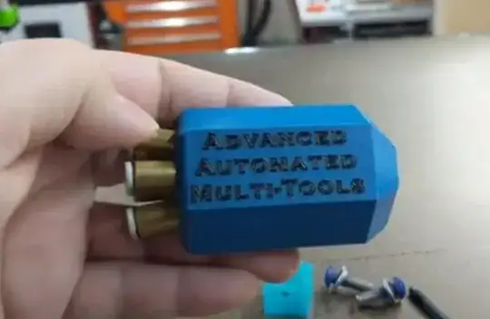

After adding the powder and burning it in with a lower power setting (9 %), the result is very legible: engraved and assembled part
