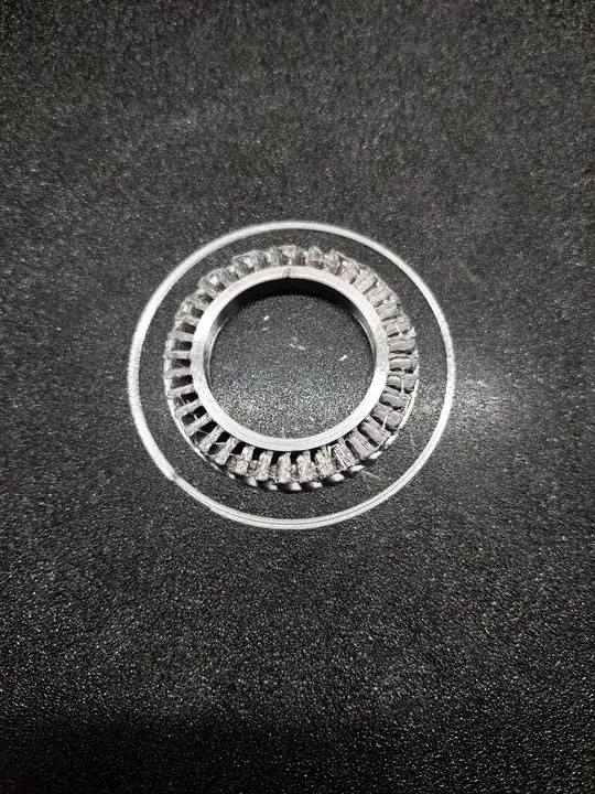

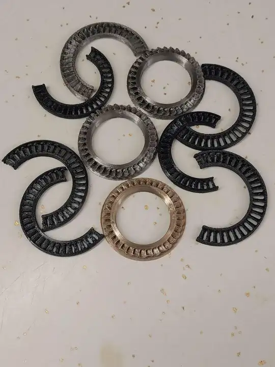

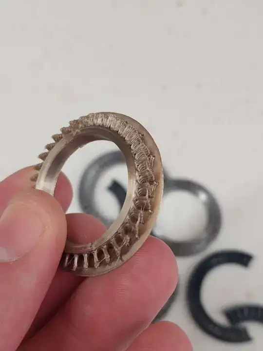

I'm trying to print a 30% version of this High Bypass Engine Nacelle, but I'm having some quality issues with the high pressure turbine compression stages.
I've uploaded several photos to Imgur here, ill include some below:
enter image description here enter image description here enter image description here enter image description here

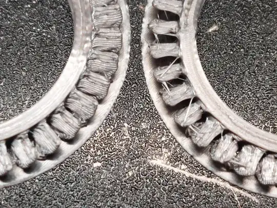

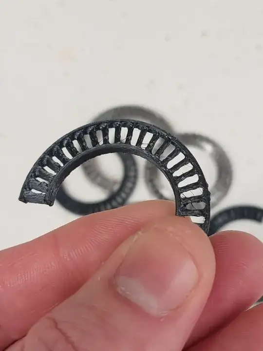

What's odd is that the stators, which are very similar in size and overhangs, seem to print much better. Here's a photo of that: enter image description here enter image description here
I have printed several retraction tower tests and selected the best values, but it doesn't seem to improve all that much. Whenever I print larger components, they seem to print just fine with very little or no stringing on the surface.
Filaments tested
Settings
  • Ender 3 S1 Pro (running klipper)
  • Nozzle: 0.4 mm
  • Sliced with Cura
  • Layer height: 0.2 mm, 0.16 mm
  • Print speed: 50 mm/s, 80 mm/s, 100 mm/s
  • Walls: 4
  • Wall ordering: Inside to Outside (my default), and Outside to Inside
  • Top: 3
  • Bottom: 3
  • Infill (doesn't matter, the walls/top/bottom make it 100%)
  • Retraction:
    • Speed: 25 mm/s, 30 mm/s, 35 mm/s
    • Distance: 0.5 mm, 0.8 mm, 1 mm
    • Retract on layer change: Yes
    • Retraction minimum travel: 1.5 mm, 1 mm
  • Coasting: Disabled
  • Temperature:
    • Extruder: 190 °C, 200 °C, 210 °C, 215 °C
    • Bed: 60 °C
  • Wipe:
    • Outer wall: 0.5 mm
    • Infill: 0.1 mm
  • Print thin walls: enabled
  • Combing: Not in skin
I'm not sure what other settings to share that would help troubleshoot this. If there's more detail that would help, lmk and ill add it.
