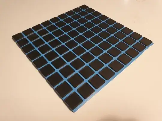

I decided to go ahead and try anyways, to moderate success.
The main takeaways:
  • M0 does definitely work as advertised.
  • During the pause, plastic had been leaking from the nozzle and down on the print, and during the filament change even more leaked out. Next time I'm doing this, I'm adding significantly more height to the line G1 F300 Z15 (right above M0) and perhaps will consider a different parking spot (the line G1 F9000 X190 Y190 right above that again) to prevent this from affecting the print
  • As I extracted the blue filament that I started the print with, I saw that a couple of milimeters at the end had gotten singed and miscolored. Not much of an issue, though, I'll just snap it off next time I load it.
  • Even though I did get plastic of the right color coming through the nozzle during the change procedure, as the printer resumed printing, it didn't actually print anything (presumably it retracted a little bit). I had to push the filament through the tube manually to get it to print correctly, but a little bit of the new layer was missing. Luckily, the next layer printed fine even without the layer below supporting it.
  • When entering which layer to pause on into the wizard, it seems one should believe the layer numbers in the slice preview of Cura and the part of the pop-up that tells you to enter the layer that will complete before the pause. Everything else around this confused me into suspecting an off-by-one error somewhere, but those were just red herrings.
In the rightmost corner you can see a little bit of the damage from the leaking while swapping filament, but most of it is hidden below the black (and you can also see that it didn't stick to the build plate, but that's entirely unrelated to this issue).
