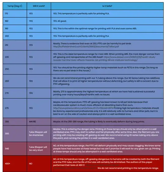

That said, if you can reason about the maximum temperature your PTFE will experience in the heatbreak (which should be significantly colder than the temperature of the nozzle), you can use this safety chart to reason about how dangerous (or not) it is to be near (see Capricorn's Safety Precautions).
Chart of PTFE temperatures against 'Is it safe?'
