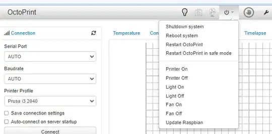

I have done this with 2 printers, one where I cut the 230 V, but the latest one uses a computer 12 V PSU which has a separate wire (I think this is 5 V) which you can short to start the PSU; this is much safer. I used and use OctoPrint with custom shell scripts to turn on the printer and the hot end cooler fan as described in this answer.
