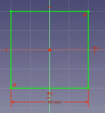

I designed a basic structure with FreeCAD. For the base, I started with a 40x40 mm square:
Screenshot of FreeCAD showing a 40x40 mm square

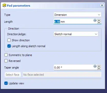

And I extruded it with 6.5 mm:
Screenshot of FreeCAD's Pad parameters dialog box with a 'Length' of 6.5 mm

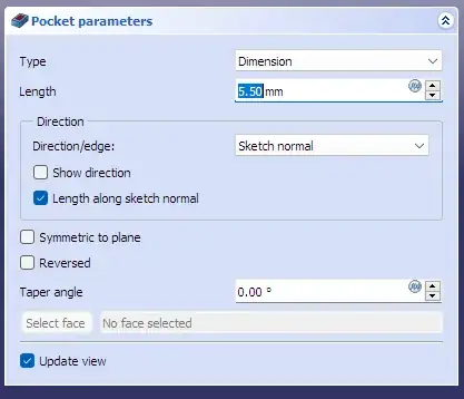

And applied 5.5 mm pocket:
Screenshot of FreeCAD's Pocket parameters dialog box with a 'Length' of 5.5 mm

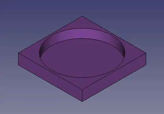

The end result looks good:
Screenshot of a square base with a circular recess 3D model in FreeCAD

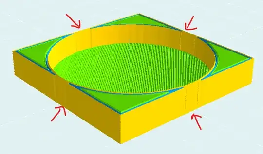

However, any slicer I know will produce a strange shape around the middle of the sides both inside and outside:
Screenshot of a sliced model with unknown artifacts at the tangent edges of the circle and square sides
There is a 1 mm thickness there, so I don't understand why are those shapes presented.

It's not FreeCad, it is the shape you want to create. The wall has 1.0 mm thickness. I assume that you are using 0.4 mm nozzle. With default extrusion width of 0.45, you can get either 0.9 or 1.35 mm thickness, 0.9 obviously being closer to desired.
1.0 mm wall width
The other issue is, there's no space for four perimeters. So, at the point where internal perimeters end, slicer need to move external perimeters closer together, to make them fuse properly. Thus, even at 0.5 mm extrusion width you will see this collapse. To prevent this effect, you need to either use smaller nozzle that would allow for internal and external perimeters to be continuous, or change your geometry to make it compatible with FDM process.
Note that, if you want consistent prints, you shouldn't set extrusion width (or wall thickness, or however it's called in your slicer) to the value lower than the diameter of your nozzle. Even making it equal is risky. For this situation, I'd suggest 0.2 mm extrusion width on 0.15 or 0.18 nozzle. Or redesign.
Wall collapse
