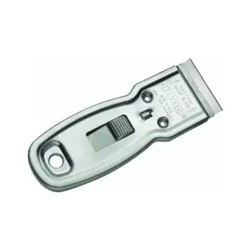

My usual solution for cleaning the glass bed on my printer is a glass scraper (basically just a razor blade with a handle on it):
glass scraper
Regardless of what kind of filament (abs/pla/nylon) or surface treatment (glue/painters tape/abs slurry) I've used the glass scraper always takes it right off, and with the style I posted a picture of the blade is flexible and thin enough it's also useful for peeling up the edge of prints that are stuck to the bed.

I use a razor blade scraper to get stuff off that is sticking. Priory to printing I heat and level the build plate, then wipe it down with alcohol to get any greasey fingerprints off of it.
My Scraper
