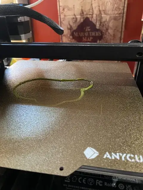

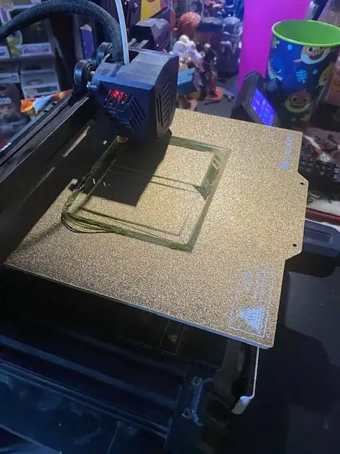

I can’t figure out what the issue is. The far side of the bed (Y-axis) print won’t adhere because the extruder is too far off while on the near side is too thin. I have tried all the troubleshooting tips I can find online and nothing worked. Even as a last resort, I tried shimming the far-side bed screws and still have the same results after auto bed leveling.
Photo of the first few layers of a printed model but front edge is very thin on the build plate
Another photo of a printed model again with a thin front edge

If you did not resolve this, you can try a couple of things: You'd need OctoPrint and the "bedvisualizer" plugin installed. I've had a similar problem with my Kobra standard and found out that it was totally off-level. If the issues persist, please download/install both and send a screen capture of the bed level so we can go from there!
