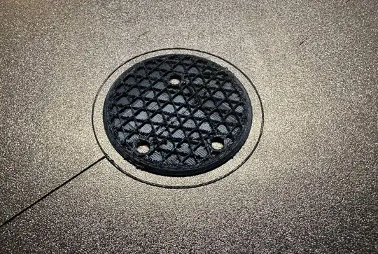

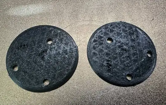

I own a Qidi X-Plus 3D printer and have been trying to get it to print properly but to no avail. I've leveled the bed and have been fiddling with the Z-offset yet my prints still fail. Weirdly enough, the 3D prints seem to start off okay, however, after a while, they come out stringy, and then the extruder just stops extruding the filament altogether. I had something like this happen a while back which I sort of solved by adjusting the Z-offset but that doesn't seem to work now. Any ideas on why this happening?
Here are some failed prints: enter image description here
