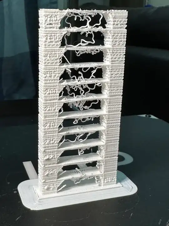

temperature tower I printed when I noticed the unwanted temperature fluctuations

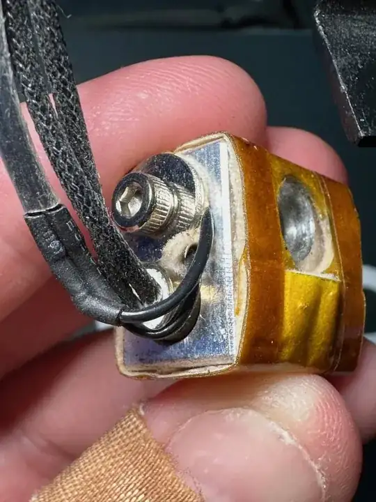

  • gently tightened the thermistor screw just so that it was snug, but not overly tight
Here's the thermistor connection on the hotend:
Any suggestions are welcome.
