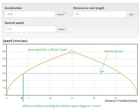

A tool that you might find useful for experimenting with acceleration is RepRap Centrals Acceleration Calculator (at the bottom).
By setting an acceleration, length of travel and target speed, you can see:
  1. The theoretical speed that can be achieved during the travel with your set acceleration (yellow line).
  2. The distance required to reach your target speed, and for how long it will hold that speed before slowing down (blue line).
For instance, setting acceleration = 3000, length = 30 and speed = 150 means it will travel 4 mm before reaching its desired speed of 150 mm/s, while that same acceleration theoretically could give a speed of 300 mm/s for the given distance:
