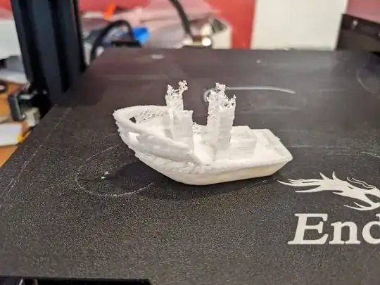

Sorry this is kind to embarrassing to post compared to other images but this is our first attempts. It starts out roughly acceptable then does this waffle thing. I tightened the belts and leveled the plate.
I have a Creality Ender 3 which I use together with UltiMaker Cura slicer. I print in PLA at 220 °C. The print bed is set to 70 °C. I use a print cooling fan at 60 %. The layer height I set to 0.[?] mm, the line width [line width/extrusion width] from the 0.4 mm nozzle. The Printing Speed is set to ? mm/s for walls and [?] mm/s for infill]. My retraction is [?] mm/off at [?] mm/s.
Problem seems to be solved, thanks everyone. I dropped the temperature to 200 and fan speed to 100% and print looks much better.

This is a severe under extrusion problem.
What slicer are you using? It could be a filament diameter setting issue.
Are you using Cura? I don't know about the most recent version but older versions defaulted to 2.85 mm filament diameter which is the diameter the Ultimaker printers use (as Cura is developed by Ultimaker) but the Ender 3 uses 1.75 mm diameter filament.
Have a look at this question where a similar issue is discussed.

You've probably checked this already but offering a basic issue I've had before on my Ender 3 with the filament not unraveling cleanly from the spool hanger (gets caught on the post or bound up on itself).
When this happens it would produce a similar result to your picture...started fine and then turned into wispy/burnt layers before ending entirely.
When this has happened I just need to untangle the filament, clean the nozzle, cut a clean starting point on the filament, and empty the Bowden tube of the old filament.
