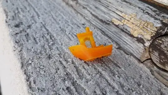

255 degrees 0.6*0.3 40mm/s

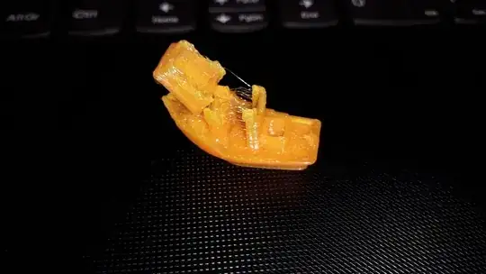

The same benchy broken

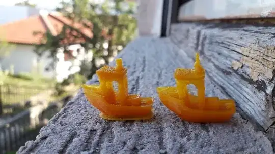

Left: 263 degrees 0.60.3 30mm/s, right: 255 degrees 0.450.2 40mm/s

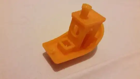

100% 250 degrees 0.6*0.3 80mm/s
