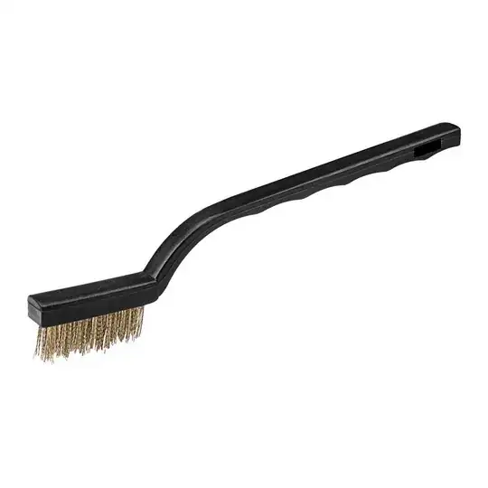

You just need the right tool for this, a brass brush, something like:
brass brush sample
They're typically available for less than a dollar from hardware stores, or you can order them various places online.
Use it while the nozzle is hot, and with the sock removed, and everything should come right off. Take care not to brush the electrical connections to the heater/thermistor, since this might cause a short and fry your controller board if any conductors are inadvertently exposed.
