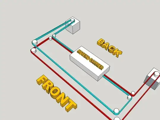

This is a diagram of the setup:
CraftBot XL layout
What else could be causing this? I don't hear any out of place noises like metal grinding.

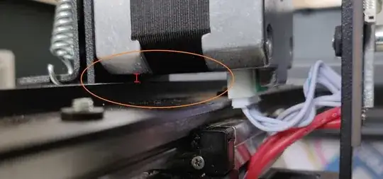

I'm going to answer this myself, as I believe I have found the issue. It was purely a mechanical issue.
On this particular model, the extruder motor rides just on top of / above the crossbar that the linear rail is mounted under. The extruder motor was mounted very close to this crossbar, there was barely any clearance between the two. I figure that due to a slight deviation in height or non-squaredness in the ZY-axis, the motor started to heavily rub on the bar toward the left extent of the X-axis. I tested with a piece of paper, which I slid between the motor and the bar. This immediately caused the same "resistance" I was feeling before, but now everywhere along the X-axis.
After re-mounting the extruder motor about 1 mm higher, which the frame already allowed for, there is no longer any improper resistance noticable along any axis:
Adequate clearance between motor and bar
