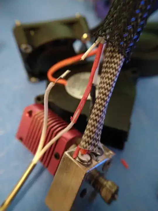

I'm using a 65W heater cartridge and T-D500 type NTC thermistor. This setup has been working fine since I installed it sometime last year. Suddenly today, the temperature reading started jumping around 5-25° below the set temperature, but only while printing. It holds temperature solid at idle, and PID autotune produces numbers like normal.
How should I go about diagnosing what component is bad? Is it necessarily the cartridge or thermistor (or rather their wiring) or could it be noise or voltage instability or something else?

Update: After limping along for a good while on the 100k NTC thermistor bead, I finally disassembled everything to replace the T-D500, and immediately found the culprit. The wires to thermistor are not a single piece, but were sloppily solder-joined and heat-shrink-wrapped by the vendor(/reseller?) a few centimeters from the thermistor. This exact point in my wire harness was somewhat strained at the point where it exited between the hotend enclosure and extruder body, and apparently suffered a hairline crack that fell apart completely during disassembly:
photo of disassembled toolhead with broken thermistor wires
To make it easier to switch thermistors in the future if I need to, and since I was needing to learn crimping, I put JST-XH connectors on both sides where it was broken, and shifted the junction to sit inside the enclosure but away from the heater block. It's now fully operational again, and the replacement I purchased is still sitting in its bag as a spare.
