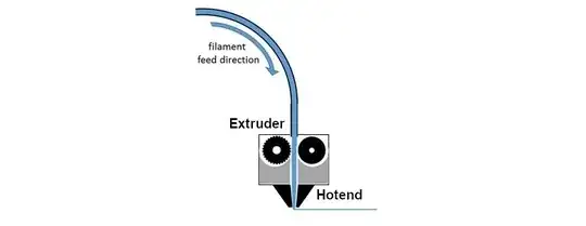

A Bowden extruder has the motor located remotely from the hotend, usually on the printer's frame. Filament is fed from the motor to the hotend through a Bowden tube. This setup is typically used in 3D printers that require high speeds and accelerations, as the reduced weight of the hotend allows for faster and more accurate movement.
Visualization of the Bowden extruder system
The main advantage of a Bowden extruder is that it reduces the weight of the printhead. It can improve print speed and accuracy, especially for faster print speeds. It also reduces the amount of space required in the printhead, allowing for larger hotends or additional features to be added.
However, Bowden extruders can suffer from problems with filament control, such as oozing or stringing of the filament. The friction in the Bowden tube and distance between the extruder and the hotend causes the reaction time of each motor movement to be extended.
